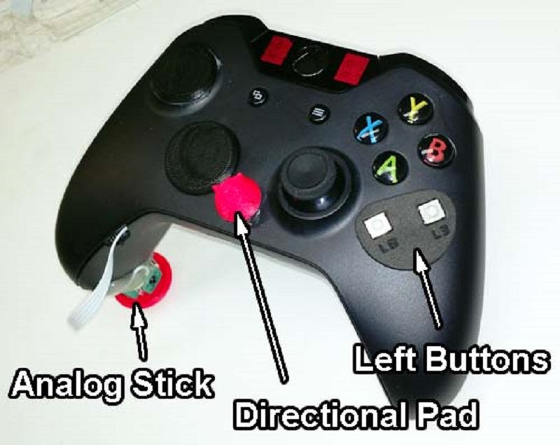

3D printing plays a key role in the builds. The two use the technology to create a variety of parts such as actuators, internal structures, and even the all-important buttons that dot the device, according to Heck.
“[3D printing] has been really useful, you wouldn’t have been able to that in the past,” Heck said in an interview with Product Design and Development. “It would have worked, but you would have had to stick everything together with hot glue.”
Shown is one right handed accessibility con rollers that Ben Heck and Felix Gardner build for disabled customers. (Image: benheck.com)
To modify the controller Heck or Gardner take the original device apart, followed by the implementation of face buttons. One of the two then create the controller’s directional pad and add a 5-way tactile switch. Next, patterns are laser cut in the controller’s front shell so that they know where to add holes. Finally, Heck or Gardner hand drills and hand wires the controller.
Aside from the 3D printed parts, the controller is pieced together by hand. The end product features a 3D printed knob replacing what was originally the second analog stick, which is placed against the leg opposite the hand that is being used. The gamer than moves their arm to move the stick.
For example, if the controller is made for a person who only has a functional right hand, the joystick for the leg would be put beneath the left bottom of the controller. A 3D printed directional pad, or D-pad, for a right-handed Xbox controller is then placed to the right of where the original D-pad was placed. The buttons that would have been on the left side are then placed on the right side, below the traditional x, y, a, and b buttons. The second analog trigger is moved to the back right of the controller. Finally, the parts of the controller that no longer have use due to the modification are hidden by 3D printed covers.
