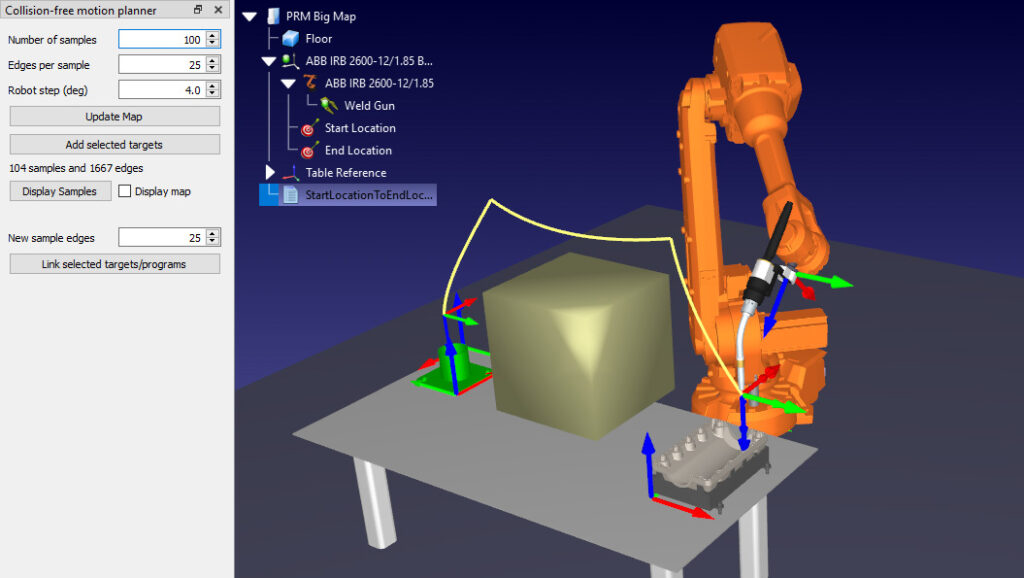

Managing motion trajectories is a computing challenge. Just to crunch the numbers and resolve the mechanical organization of a robot into individual axes of motion consumes a good bit of electronics processing power.  But assume the move profiles are processed before a move is initiated. That task by itself pales in comparison to monitoring the individual axes on the fly … and executing following-window errors on all axes (so mechanical errors will bring the robot to a halt).
Image courtesy RoboDK
Then when the robot is halted, what exactly constitutes a safe condition?  Is that a hold position? A return to home at low speed? All these definitions must be well defined before a robotics system can be put into operation.
See how Realtime Robotics simplifies motion planning at this article on rtr.ai.
