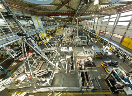

As igus operates the largest laboratory for continuously moving cables in the industry, spread over 1,750 sq. m., igus can give accurate information about application potentials and service life. (Source: igus GmbH)
