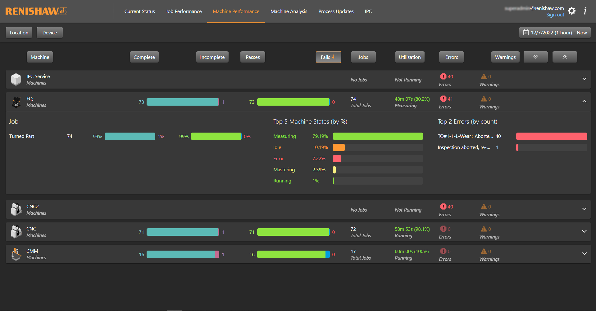

A screenshot of Renishaw Central machine performance by job and top five machine status states.
The Renishaw Central platform monitors machine performance — not operator performance — to give a factory-wide view of capability, quality, and process control. Image courtesy of Renishaw.
Additionally, Renishaw Central isn’t designed as a catch-all for any factory data. However, it does use a Web API that can connect to various data sources and software. For instance, during the resolution workshops, Renishaw realized they needed to aggregate multiple data sources to build dashboards. So, they started using Power BI to create custom reports and review past data.
