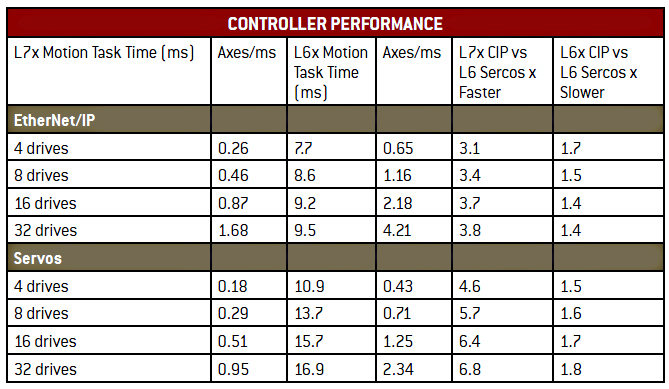

EtherNet_IP-module-chart
The EtherNet/IP module can support 8 drives/ms, with 35% bandwidth remaining for support of other class 1 and class 3 traffic. In addition to drive attribute, read and write support is available through the cyclic channel for single coarse update rate throughput, and registration arming and relative homing is supported through the event channel for single cycle throughput.
