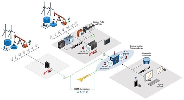

Here’s our go-to formula for setting up an MQTT network that provides a full set of integration options and can also be tested out at no cost:
A starter MQTT network using groov EPIC and Ignition
  1. Download and install Ignition to a local computer (Linux, Mac, Windows). It only takes a few minutes and is fully functional in two-hour increments.
  2. Within Ignition, install the Cirrus Link MQTT Distributor module (Modules > Install or Upgrade a Module). You now have a scalable MQTT broker.
  3. Next, install the Cirrus Link MQTT Engine module. Non-MQTT applications can now access your MQTT data through Ignition’s OPC UA Server.
  4. On your groov EPIC, enable Ignition Edge to access OPC drivers for Allen-Bradley, Siemens, and Modbus/TCP; or leverage integration kits for PAC Control to access a variety of serial protocols. You now have an MQTT gateway (EoN Node) for all your legacy devices.
Ready to go, and you haven’t spent a dime! Experiment as much as you want, and when you’re ready for prime time, all you have to do is license the system.
With this setup, you can connect MQTT-enabled devices, legacy automation, traditional I/O, and all kinds of databases and applications to your MQTT network. For more control over how databases interact with your MQTT data, add the SQL Bridge module to your Ignition server as well. Or add the Perspective module to bring your MQTT data into a mobile HMI.
Scale up your network with additional groov hardware, or add another broker for high-availability. You also have the option of adding protocol modules to EPIC’s CODESYS engine or running custom interfaces from the EPIC command line. It just keeps getting better, and you have complete control over how your network grows.
