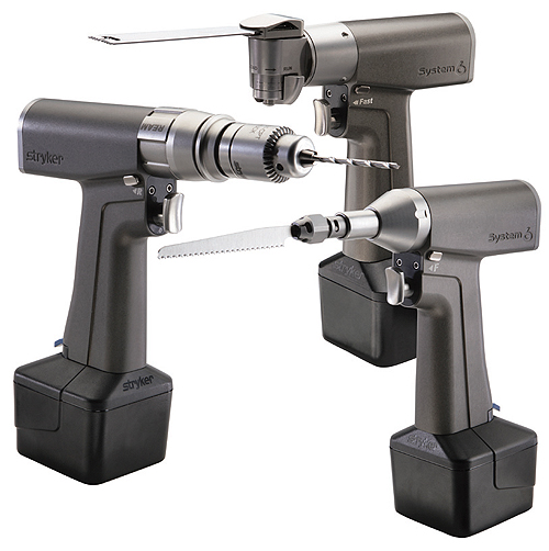

Stryker Corporation is known for its medical devices and equipment. Its products range from orthopedic implants to various surgical apparatus.
