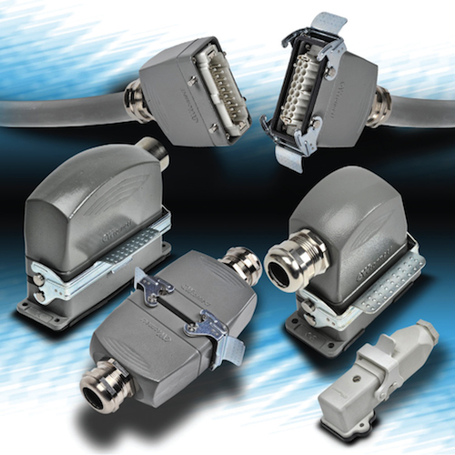

The ZIPport™ product line now includes the standard series multi-wire connectors. The heavy-duty connectors maintain reliable electrical connections while providing protection against dirt, moisture, and mechanical stress common in industrial environments. Available in five frame sizes (3A, 6B, 10B, 16B and 24B), heavy-duty metal housings are constructed of polyester powder coated die-cast aluminum alloy. Self-extinguishing thermoplastic housings are also available in the 3A frame size. Connector hoods are available with top entry and side entry cable passages. All housings are available in a standard profile; several are offered with a high construction profile to allow more room for wiring higher density inserts. All housings feature Pg threaded cable passages; optional Pg thread to NPT adapters are also available. A single or double lever locking system assures coupling stability and protection against accidental opening.
