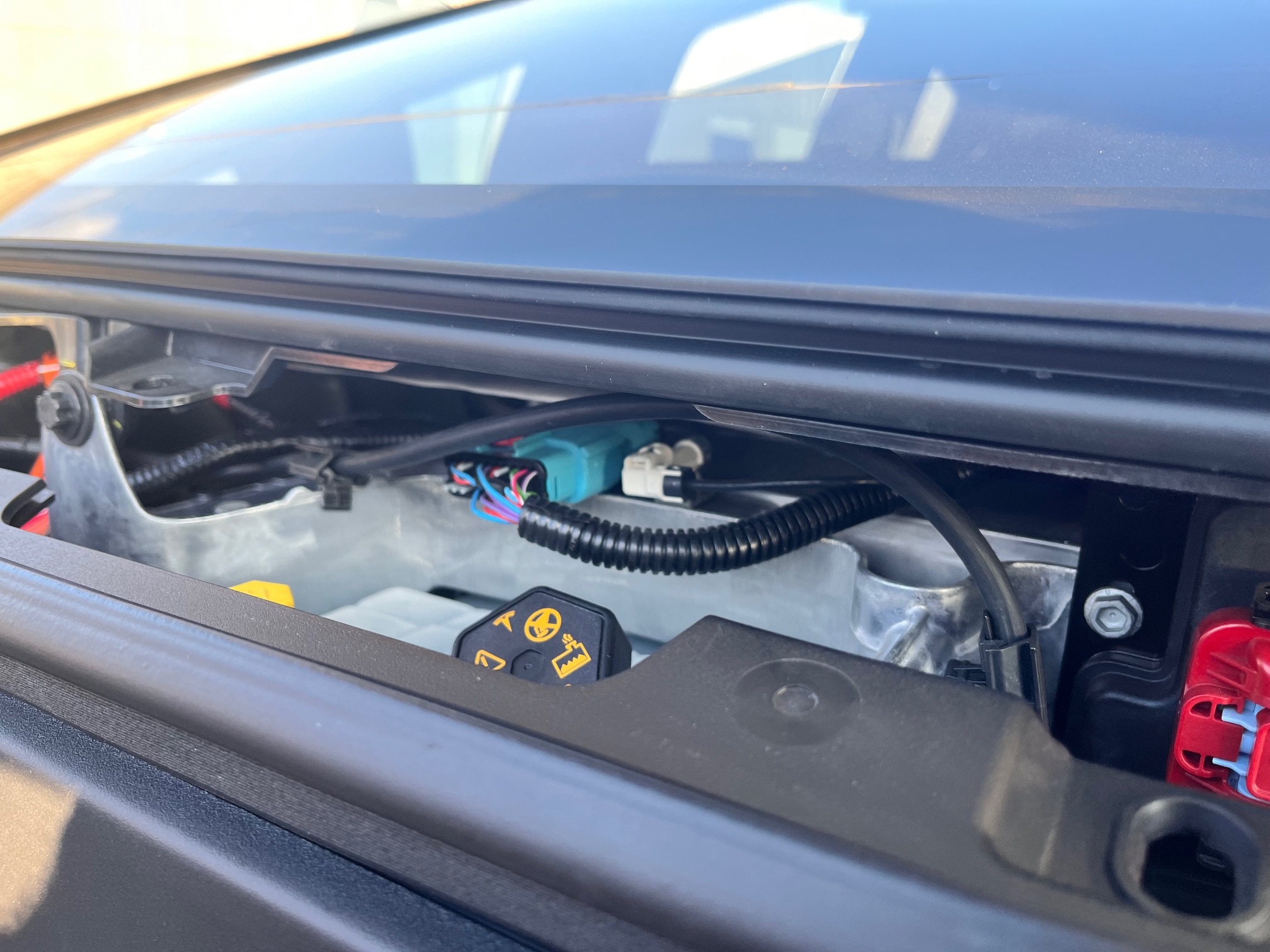

Components that adhere to USCAR/LV214 or similar qualifications are typically high-quality, rugged and reliable parts that can take a beating on the road without sacrificing performance. For example, Molex’s MX150 connector series offers components engineered for vehicles that face harsh environments and are durable against extreme temperatures, vibration and moisture.
Shown here is a Molex connector on a Cybertruck. Image: Molex
