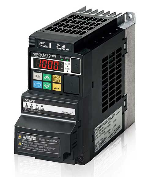

Omron-3G3MX2-AC-Drive
Compact Omron 3G3MX2 AC Drives include front panel mounting 3G3AX-MX2-EIP-A EtherNet/IP communication interface unit that imparts network slave capabilities to the ac drives. The EtherNet/IP interface makes it easy to standardize on 3G3MX2 ac drives.
Omron Industrial Automation
www.Omron247.com

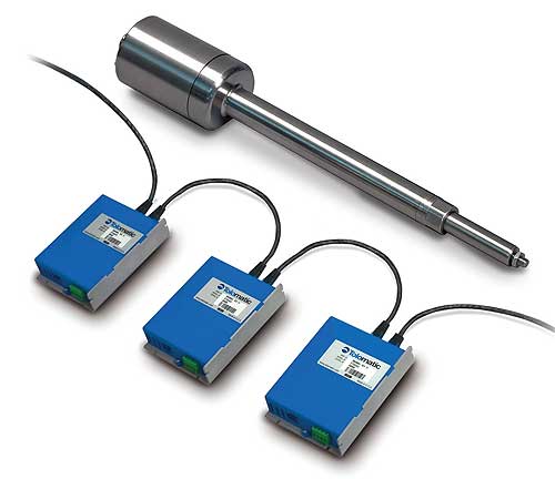

Tolomatic-ethernet
The ACS with Ethernet supports Ethernet/IP, allowing easy connectivity to Allen Bradley and other PLCs and HMIs. With built-in configurations for all of Tolomatic’s electric actuators, the ACS makes creating linear motion simple.
Tolomatic
www.tolomatic.com

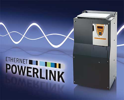

B&R-Automation-ACOPOSinverter-P84
The ACOPOSinverter P84, from B&R, includes an integrated POW ERLINK interface. Its performance range is from 0.37 to 500 kW. An encoder interface can be added to the inverter for applications with strict requirements for speed or torque control. This allows movements to be synchronized with the servo drives.
www.br-automation.com
