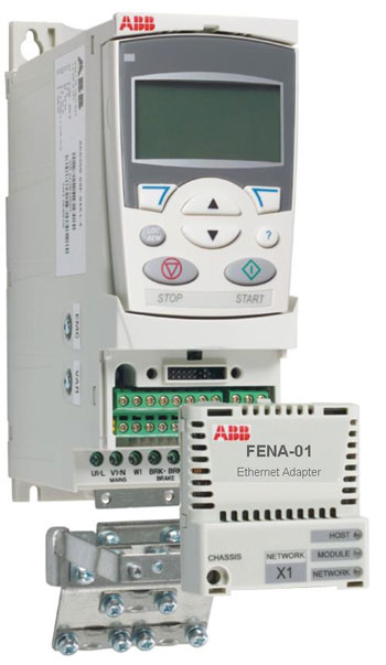

ABB Low Voltage Drives today released the FENA-01 Ethernet Adapter for the company‚’s ACS350 drive line. The FENA-01 supports both EtherNet/IP and Modbus/TCP protocols.

The NEW FENA-01 EtherNet IP and Modbus TCP adapter expands ABB‚’s universal connectivity capability, improving quality, productivity, flexibility and scalability. ‚“This feature gives the machine or system designer the flexibility to select ABB drives independent of the BAC, PLC or HMI manufacturer, ‚” Semrow noted.
