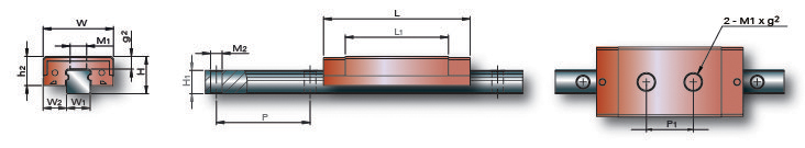

MRU 2M series 2-mm miniature linear guides get their name from several key dimensions of 2 mm:

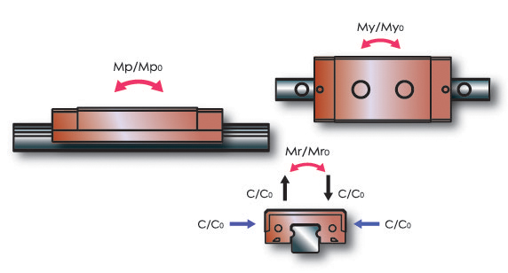

The design compactness of the 2-mm linear guides makes for top power density for high load capacity from a small design footprint. These load capacities are calculated according to ISO 14728. To compare the rating life definition and the load capacities design engineers can use the C50B = 1.26 x C100 equation.
OEMs and end users can source customized linear components from this series — and in fact, slides from Chieftek come in mostly custom lengths … even to many feet long. The manufacturer uses precision cutting and grinding processes on these miniature slides to maintain accuracy.
Design engineers can also select an optional lubrication-storage plate to store oil inside the carriage block; the number of runner blocks (carriages) to ride the linear-guide rail; the number of sections of separate rail to form a given axis; starting and end linear-guide rail mounting hole pitches; various sealing options for carriage end sealing and bottom sealing; an accuracy grade of normal, high, or precision; and a preload value for clearance, standard fit, or light preload. For more information, download this PDF on Chieftek’s full MR miniature linear-guide series:
