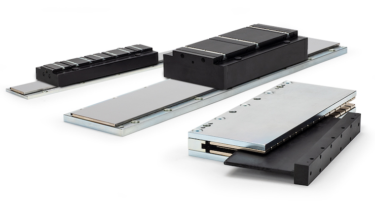

Kollmorgen’s new addition to its IC Ironcore DDL motor family expands beyond 230 Vac products with a new capability to support 400/480 Vac-powered applications.
Kollmorgen’s new direct drive linear motor delivers a continuous force range up to 8,211 N and peak force up to 13,448 N. When powered at higher bus voltages, the motor is inherently capable of delivering its rated force at higher speeds, making it suitable for applications such as machine tools, semiconductor manufacturing, battery production and industrial automation that require rapid and precise movement of heavy loads.
In environments with a 400 or 480 Vac bus voltage, the IC Ironcore DDL may eliminate the need for a transformer that would otherwise be required to run a motor with a lower voltage rating. In addition, a motor that runs at a higher voltage can perform a given amount of work at a lower amperage level. This lower current draw in a higher-voltage environment may allow for the use of a smaller drive amplifier and a lighter cable set.
linear motor
With smaller drives, lighter cables and no transformers, machine builders may be able to use a smaller control cabinet with lower cooling requirements. In addition, the IC Ironcore DDL motor also offers a water-cooling option that increases continuous force output by up to 40 to 60%, potentially allowing specification of a smaller-size motor. All of these advantages support a lighter, more compact, and sustainable machine design that’s simpler and more affordable to build and delivers greater value to both OEMs and their customers.
Another key benefit of the IC Ironcore DDL motor is that it enables OEMs to serve global markets without significantly redesigning their machines for each region. The 230/400/480 Vac bus voltage rating meets the needs of most customers across North America, Europe and Asia. The motor is UL and CE Certified — plus RoHS and REACH Compliant — simplifying the approval process for selling machines in each target market worldwide.
The IC Ironcore DDL motor joins Kollmorgen’s complete lineup of direct drive linear motors including the ICD Ironcore Low Profile DDL and the IL Ironless DDL. When paired with AKD or AKD2G servo drives, these motors offer ultimate precision, smoothness and reliability for demanding applications. AKD2G dual-axis servo drives can even synchronize two motors — for example in an x/y table application — while saving even more space in the control cabinet.
