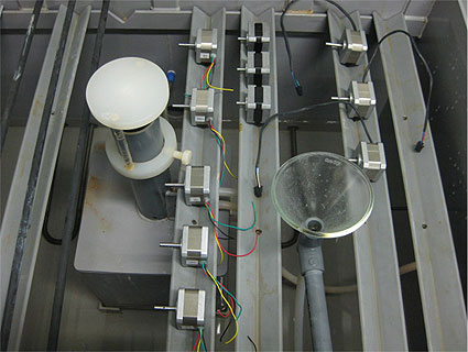

The MIL-STD-202G standard
To test their new coating system, Moons’ used the MIL-STD-202G, a salt-spray test where the device under test is subjected to a fine mist of salt solution. In general, the test does not indicate whether a device or material will survive under any and all corrosive conditions. What it does best is help to evaluate the uniformity of protective coatings.
MIL-STD-202G spells out a number of test parameters including the exposure chamber, a salt solution reservoir, an atomizer for the salt solution, controls for chamber heating and a means to humidify the air.
The parameters for the salt spray test setup (shown in the photo) were:
5% (+/-0.1%) concentration of salt solution
6.5 – 7.2 pH
35 +/-2°C
1 kgf spray pressure
140 hours of continuous spray time
The test setup used in the salt spray test using a 5% salt solution.
