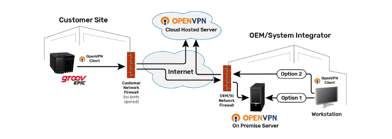

These are all potential ways direct VPN can enhance your product offering or even spin-off billable services. But with groov EPIC, VPN is even better. Historically, gaining VPN access to remote equipment required the customer’s IT staff to grant you access to their VPN server after creating a secure internet connection to their equipment. Not always a fun conversation. To simplify this, a common alternative is to use a dedicated VPN router on-site with a connection to a hosted VPN server. Both of these options come with up-front and on-going costs, however, which may not be feasible for the applications I mentioned above.
However, because the groov EPIC is essentially an industrial Linux PC, it’s highly customizable, with an array of enterprise-grade IT tools available from the open-source world. In the latest firmware release, we baked OpenVPN client configuration into groov  Manage so you can have secure VPN access without touching your customer’s IT. All the EPIC needs is internet access to an OpenVPN server, and since groov EPIC is not a router, there is no risk of exposing the control network to the outside.
Already have a VPN server? Many support the OpenVPN protocol. Provide the necessary information about the server and the connection through groov Manage, and now you can tap into that resource to securely communicate with your groov EPIC processors. By all means, you should be following best practices, like segregating your trusted and untrusted network traffic using Eth0 and Eth1, closing unused ports, and taking advantage of user access controls, but with this combination of features in groov Manage we finally have a realistic business case for equipment-level VPN.
