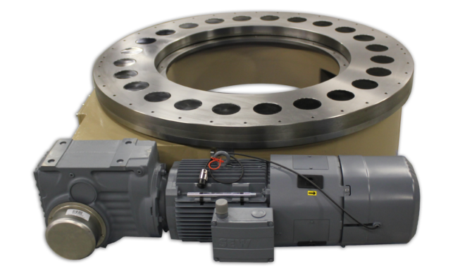

RT Series servo-rotary tables come in myriad sizes, and their ultra-precise cam assemblies can be custom-made to order by Motion Index Drives. The tables either come with a fixed number of stations or with flexible dial output (running off a servomotor or ac brake motor with encoder).
