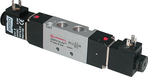

Littleton, CO – Norgren announced the launch of a new value-minded pneumatic valve series, the V50-V53 offered in 1/8”, ¼”, 3/8” & ½” NPT or ISOG port sizes.
The V5X range provides a complete offering of valve functions including: 3/2 & 5/2 solenoid/spring return (sol/sprg), 3/2 & 5/2 solenoid/solenoid (sol/sol), 5/3 All ports blocked (APB), Center open to Pressure (COP) and Center Open to Exhaust (COE). The new series is also IP65 certified and backed by Norgren’s standard 2 year warranty.
V5X is available in 24Vdc, 12 Vdc and 110/120Vac. Power consumption is 2.5W in the V50, and 2.0W in the larger ported V51-V53 products. The series also offers extended push/turn locking manual overrides, provides single & double air pilot valves and are supplied with a din connector.
