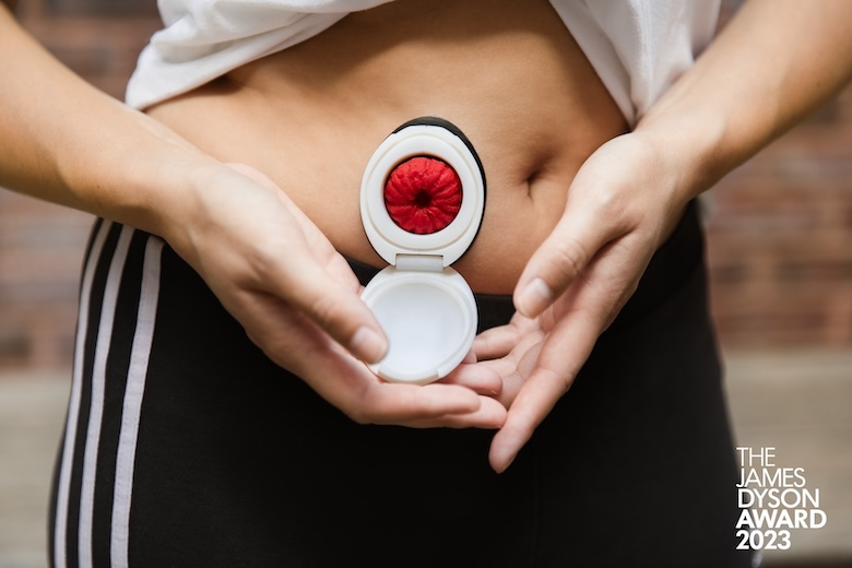

An original OriVa prototype attached to a person with the lid open showing the flexible wafer inside
Shown here is the original 3D-printed prototype with two components: the flexible wafer and the hard base. Böhning is working on new OriVa prototypes and combining the two components into one contiguous piece. Image: Dyson

Böhning: Originally, we had the wafer and the port as separate pieces so the port could be attached to the wafer. We recently started printing the wafer first with a flex material and then printing the port directly onto the wafer so it’s one continuous piece. That’s been an exciting development because I was always curious about it, and having fewer seams in the design helps reduce the chance of leakages. It’s a more seamless user experience where you have fewer parts to connect. That’s been the first biggest change.
Second, in the original design, the port opens away from the body and extends out. We have been exploring different configurations, whether it has to be a hinging lid or if it can be something like a squeeze pop lid. So, small little tests with users to see which interface is most comfortable and makes the most sense for cleaning.
It’s been taking small design interventions and steps and making really incremental, small changes. But I would say the biggest is connecting the two pieces. And it’s cool from a printing perspective because you’re doing two different materials in one print and having the flex material with the hard, durable port.
