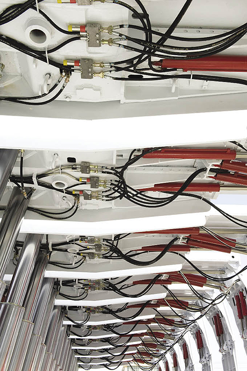

Traditional hydraulic valves are being ousted in favor of sleeker, lighter and hardier cartridge valves. With the ability to be mounted straight into machined manifolds that internally connect the valves rather than external piping as in the case of traditional valves, these hydraulic integrated circuits (HICs) eliminate unnecessary tubes, hoses and fittings. As each fitting provides two potential leakage points, the basic principles of hydraulic machinery operations are upheld to a higher standard.

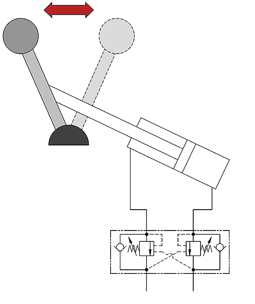

To explain the need for overcenter valves, the perfect example would be an inverse pendulum, as shown in Figure 3. Here, a cylinder is attached to a pendulum which has a load at its end. The cylinder’s retraction and extension helps the pendulum sway backward and forward. To push the pendulum from one extremity to another during its ascent, the cylinder acts against the load and the force of gravity—hence the pendulum is always in control with the pump driving the load.
As the pendulum goes over its center of gravity and starts its descent, the load becomes unbalanced, with the pendulum trying to move faster than the cylinder will allow it to. Now the load ends up driving the pump since the load and gravity are acting in the same direction as the cylinder. Here the overcenter valve would regulate the movement of the cylinder by metering the flow out of it and subsequently keeping the load in control at all times.
Since the scenario is repeated in the reverse direction, a second overcenter valve is required for the same reason on the opposite line. In this case, a dual overcenter valve is used, which regulates the flow out of a cylinder at both ends.

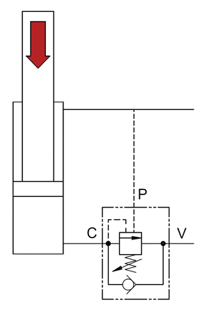

In Figure 7, the cylinder has to be extended against the weight of the load—the oil flows to the cap end over the check valve extending the piston, while the opposite end is drained of oil. For retraction, the overcenter valve restricts the flow of oil out of the cap end, resulting in the pressure rising at the opposite end. This pressure is sensed at the pilot port of the overcenter valve, which, assisted by the load induced pressure, compresses the spring giving an outlet to the oil from the cap end.
If the load were to run away, the flow out of the cap end would increase starving the rod end of oil, resulting in a drop in pressure. Consequently, the pilot pressure would no longer be high enough to keep the spring compressed. This shuts off the flow moving out of the cylinder. In this way, the load and its movement would be back under control by continuously metering the flow out of the cylinder.
