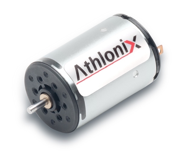

Coreless dc motors like the Portescap Athlonix range can increase dynamism and efficiency.(Image credit: Portescap)
The robot developer also wanted to extend battery lifetime, so the motors needed to have high efficiency. With more than 20 motors per unit, and robots used across a diverse array of environments, reliability was also a priority. The relatively high number of motors per robot, combined with the purchasing demands of the end- user markets, meant that the need to balance cost with value was also important.
The engineering team determined that the characteristics of a brushed dc motor would best fulfil the requirements. Providing simplicity of control, this motor design would ensure integration with the humanoid’s existing architecture. While achieving the cost-point required by the OEM, the inherent characteristics of a brushed dc motor would be well-matched to a humanoid’s close human interaction, where the advantages of high torque at low speed would enable fine control.
