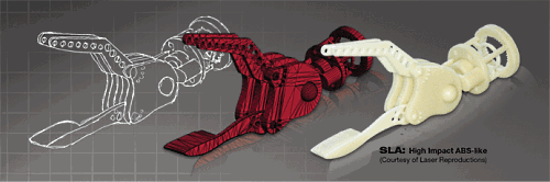

Fig.2-The
original robotic wrist is ‘consolidated’ into a single part,
manufactured using the SLA® process in high-impact ABS-like material.
The original design called for three plates, three standoff posts, and
two adapters, for a total of eight parts, not including the screws. In
addition to reducing part complexity, layered manufacturing also
eliminated tooling for those eight parts.

For example, consider the robotic arm (figure 2). The original design for the wrist consists of three plates, three standoff posts, and two adapters, for a total of eight parts, not including the screws. With layered manufacturing, that assembly is combined into a single part; a part that would be impossible to make with CNC or molding methods. Layered manufacturing eliminated tooling for those eight parts, and the bill-of-materials is reduced by seven parts.

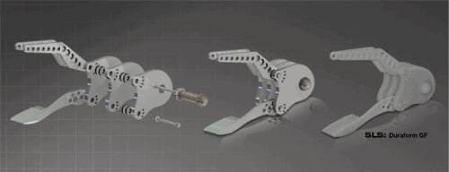

Layered manufacturing excels when parts are designed to be made together. This is a new way to think about design-for-assembly. Look at the hand of the robotic arm of figures 3 and 3A. Its original design requires separate parts for each finger, palm pads, joint pins, and washers. The layer-based manufacturing version, however, provides a complete single hand part that
still meets the product requirements for function, accuracy, and strength.
In this example, 15 separate parts are reduced to one, which reduces inventory. The design also eliminates unique tooling for each of the parts, which reduces cost and lead time. Changing the hand “on-the-fly” to suit customer needs, such as shrinking or expanding its size, is simple.

Fig.3-With
LVLM, the robotic hand was designed to be manufactured in the RP
machine as a single assembly, with the movable parts designed with
clearance and ‘grown’ together. This assembly is manufactured with the
SLS® process in glass-filled nylon.
