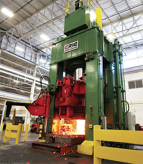

McInnes Rolled Rings brought these concerns to Erie Press when McInnes decided to invest in a new forging machine: A 3500-ton ring preforming press. McInnes manufactures seamless rolled rings ranging from 4 to 144 in. in diameter, using carbon, alloy and stainless steel. The company wanted its new, three-story hydraulic press to consume less energy than its predecessors. In common presses, the hydraulic motors run whenever the machine is on, even if the press is not being used—wasting energy and increasing wear and tear on a machine that costs between $10 million and $20 million upfront.

For the first time, Erie Press designed a drive into one of its presses—an Allen-Bradley PowerFlex 755 variable frequency drive (VFD) with a power range that extends up to 2400 hp. The VFD controls the frequency of electrical power supplied to the motor, distributing the right amount of power when the motor is in use and allowing it to idle between pressings.
Because of this, simpler and more cost-effective, fixed-volume pumps were installed. Unlike the variable pumps Erie Press had been using, fixed pumps only allow a certain amount of oil to cycle through the pump.
“Because of the drive’s ability to manipulate the speed of the motor, these pumps are always in the sweet spot,” Goodwin said. “They never apply too much pressure or too little—it’s always just right.”

The new machines use 30% less energy than conventional presses. The PowerFlex 755 drive also eliminated the need for variable volume pumps, allowing Erie Press to choose fixed-volume pumps, which are 35-40% cheaper. Considering that this particular press used eight such pumps, the savings was significant.
In addition, the drives allow hydraulic pumps to run at a speed below 1800 rpm. This not only saves energy, but reduces pump noise and heat, lessening the need for sound protection and cooling inside the plant. Since hydraulic pump life is based on pump rotation, reducing the speed of the pumps increases their life by reducing wear and tear.
