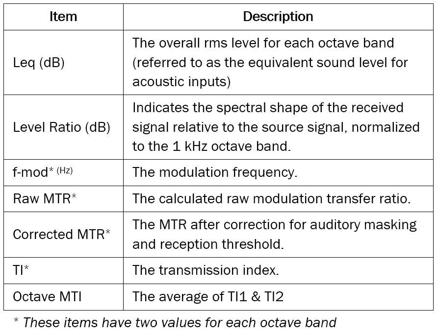

Generally, an STI signal is formed from seven octave-band noise signals, with overall spectral shape matching the long-term average spectrum of speech. Each noise carrier is modulated with one or more of 14 low frequency sine waves at modulation rates from 0.63 Hz to 12.5 Hz, spaced at 1/3-octave intervals. The STI signal passes through the transmission channel with the output signal captured at a listener position. From this output signal, the modulation transfer ratio (the reduction in modulation depth) is determined and used to calculate a single-number STI value.
Full STI requires 98 test signals to be applied sequentially; each measurement takes about 10 seconds for a total measurement time of approximately 15 minutes. The subsequent STI for Public Address (STIPA) standard uses simplified, faster, and more practical methods, making it popular.
In STIPA, each of the seven octave bands contains a pre-defined set of two modulation rates. These 14 combinations are generated simultaneously in one signal and processed in parallel, to reduce measurement time to between 10 and 20 seconds. To date, however, the method has only been standardized for the male speech spectrum.
Figure 1: The STIPA Analysis Details result and definitions.
Although the STI approach might seem similar to audio measurements like Perceptual Evaluation of Speech Quality (PESQ) and Perceptual Objective Listening Quality Analysis (POLQA), both PESQ and POLQA were developed to measure speech quality over telephone transmission networks in ideal listening conditions with very little background noise. STI, however, is a metric for speech intelligibility more applicable to high-noise environments where intelligibility is primary and quality is a secondary concern.
The STI uses the modulation transfer function (MTF), which is the ratio of modulation depth of the received signal to the modulation depth of the transmitted signal as a function of modulation rate. Distortions in the transmission channel, such as noise, reverberation, echoes, and digital codecs, reduce the modulation depth, and distort speech intelligibility.

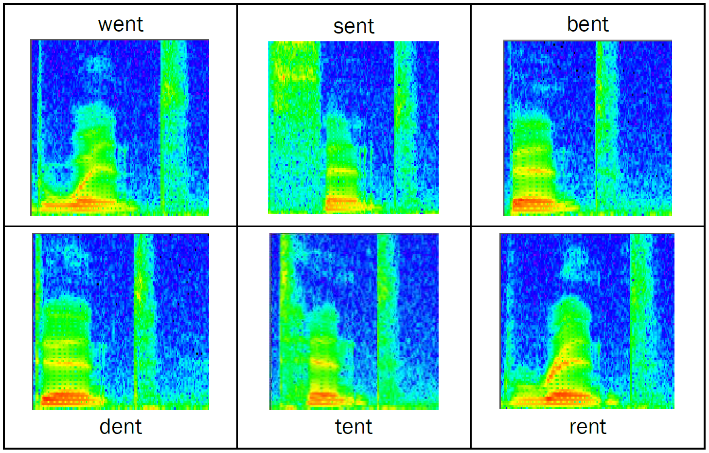

The algorithm uses time-frequency (T-F) representations of keywords in the MRT. The T-F pattern of an impaired speech signal is correlated with corresponding patterns of the six unimpaired options from a list of six rhyming words in multiple AI bands (Figure 2).
Figure 2: Spectrograms of the six keywords in the MRT list.
The top image in Figure 2 is a spectrogram of the sentence “Please select the word went,” as spoken by Female 1 in the Institute for Telecommunication Sciences (ITS) ABC-MRT speech database. The frequency is from 0 to 10 kHz and the time span is approximately 2 seconds. The significant levels are represented by blue (low) and red (high). The portion of the spectrogram containing the keyword “went” is highlighted with a red rectangle. The bottom images show the spectrograms of the six keywords from the list, plotted on the same time and frequency scales.
For each trial, a sentence containing the carrier phrase and keyword is generated and passed through the system, or Device Under Test (DUT). The signal is acquired from the output of the DUT and transformed to a T-F pattern using the same technique applied to the 1,200 isolated keyword recordings in the database.
The keyword is located within the T-F pattern by cross-correlating it in two of the AI bands with the T-F pattern of the original keyword in the template file. The portion of the DUT’s T-F pattern containing the keyword is extracted and matched with one of the six rhyming words in the AI bands of interest. Eliminating negative results leaves 17 narrowband and 21 full-band AI band correlations for each candidate keyword. Keywords in the 16 AI bands with the highest correlation values are selected and compared to the known correct keyword. The average number of correct keyword selections over the 16 AI bands provides the success rate. The average success rate across all the trials is corrected to account for the effect of guessing in MRT tests, and provides the ABC-MRT Intelligibility Score.
