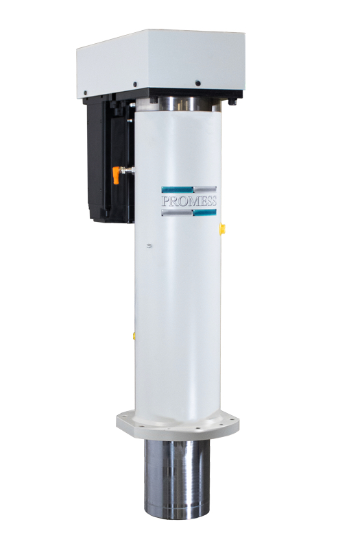

Promess engineers recommended that the manufacturer change the programming to measure more than a simple force level or distance. The engineers highlighted the benefit of combining EMAP instrumentation with the sophisticated data-processing capabilities of the Promess Motion Controller. The result is the ability to measure and control absolute force and distance and more complex relationships such as the rate-of-change between those measurements.
During installation, the Betaplug product initially moves as a unit until the lands on the outer plug body begin to dig into the bore. When adequate resistance is achieved, the plug body stops moving, but the inner pin continues to move and generates the expansion force that creates leak-tight seals and ensures retention. When the pin is 0.5 to 0.8 mm below flush, the installation tool stakes over the top edge of the plug body.
1) Force starts to increase here when the cup moves through the bore. 2) The cup stops and the pin begins moving into the cup. 3) The inflection point is when the system begins staking the part. 4) Final inflection is when staking has been finished, and the rate of change completes.
This transition produces a readily detectable inflection point in the rate-of-change relationship between press force and distance. After it’s detected, it’s a simple matter to stop the press when the pin is appropriately inserted into the plug body. The result is a properly staked installation that avoids harmful pin over-insertion. As an added benefit, the programming can also detect parts that are upside down, sideways, or missing a pin/component.
Shown here is Promess’ Electric Servo Press used to install the Betaplug product.
