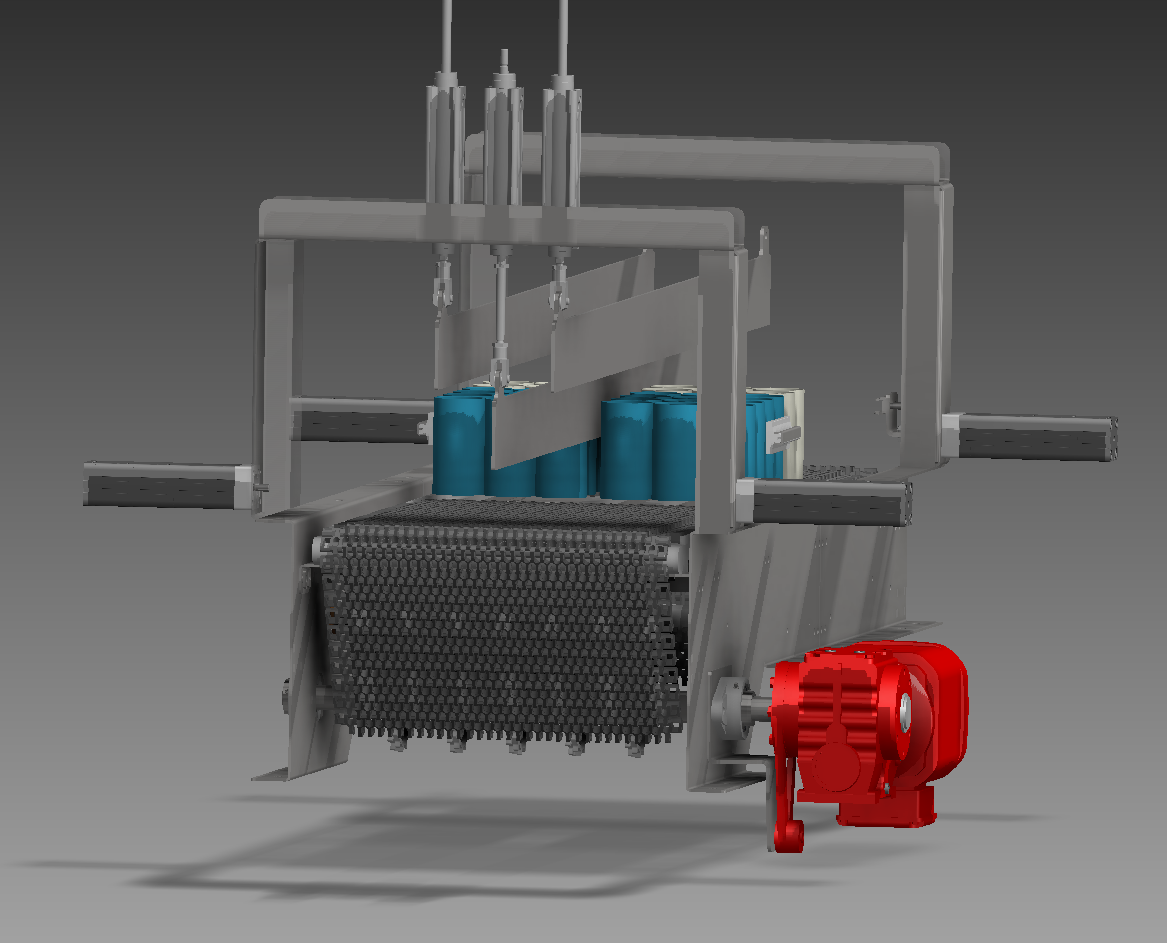

figure-two-end-view-cad-two-lane-configuration
CAD model of a two lane configuration shows the middle divider lowered.
Electric or pneumatic actuation?
The most elegant design would be to lower metal plates—dividers—between the lanes. The divider design had the advantage of being a simple, low cost solution that would maintain lane separation. Lowering the middle divider, for example, would maintain a two lane infeed. Lowering the outer plates, while the middle remained up, would maintain three lanes. Having all the plates raised would allow for one lane operation.
Guide bars on the sides of the conveyor would extend or retract to maintain proper width of the lanes.
Working with Festo, one of the company’s suppliers, the design team ran cost benefit and performance analyses on whether electric or pneumatic actuators would be the optimum choice for lowering and raising the dividers and extending and retracting the width guides.
These applications require relatively few movements per day. In terms of long service life, low cost, and high reliability in this application, pneumatic actuation clearly was the most cost effective choice. For the raising and lowering lane-maintaining actuators, a Festo design engineer suggested double rod actuators with 100-mm stroke.
“Double rod actuators provide exceptional rigidity,” said Mark Eanes, Sales Engineer. “The assured rigidity would be an asset in maintaining the specified orientation of the dividers over their service life.”
Because this section of conveyor is near a washdown area, light amounts of over spray would be part of the environment. Eanes made sure Simplimatic would receive corrosion resistant cylinders, which have-food grade grease and seals incorporated into the bodies. Adding the NSF-H1 rated grease was a custom feature, but did not require any extra time in delivery due to fast handling by the Festo Customer Solutions Group. These cylinders incorporate the company’s PPS self-adjusting air cushioning feature that provides for fast set up (no adjusting screws needed) and long service life, due to the soft stop at the end of the stroke.
For the changing width requirement, Eanes identified four position cylinders for the application. These pneumatic actuators extend or retract to four unique positions. The cylinders were also specified as corrosion resistant with food grade lubrication. Festo supplied its IP67 rated MPA-L valve manifold to control the actuators.
The unit for the Simplimatic application was a 16-station manifold. Dual 3/2 solenoid valves were used to control the four position cylinders. The MPA-L is a compact manifold with direct fieldbus communications through the Festo CPX bus node. Only one power line and one Ethernet cable had to be run to the valve bank for a clean installation. CAD models were supplied for all key components, which streamlined fabrication for Simplimatic. Eanes provided schematics of the pneumatic system early in the project, via the company’s FluidDraw software, ensuring that the functionality of the valves matched the demands of the application.
