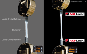

The AKI-Lock (R) technology uses the glass fibers in glass fiber-reinforced resins as a physical anchor for bonding. Glass fiber is made bare by laser irradiation which is completed in a grid pattern. Strong bonds can then be achieved by pouring the resin to be bonded onto these anchors. Since the bond is formed by physical anchors, there is no time limitation from laser treatment until bonding.
Masking is also unnecessary since specific treatment areas can be identified and there’s no need for etching solution to roughen the surface. What’s more: no waste liquids or materials are produced.
Airtightness is greatly enhanced due to three factors: the effect of resin entering and filling the gaps between the glass fibers; deformation in the grooves of the primary material due to the shear flow force of the secondary material; and crimping from mold shrinkage of the secondary material.
