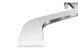

Dorner’s AquaGard 7350 V2 Curve Conveyor chain features a center bearing to eliminate friction, carry a heavier load and allow four curves to be driven by a single motor. This unique design improves productivity, along with saving valuable floor space as the conveyor can make tight turns around existing machinery and equipment without being hindered by extra motors.
The AquaGard 7350 V2 Curve Conveyor comes with infeed and outfeed sections as short at 457 mm (18 inches), enabling it to fit into tighter spaces and make tighter turns. This allows customers to save space on their production floors or fit the conveyor among pre-existing machinery.
As the newest iteration of Dorner’s AquaGard 7350 V2 Conveyor, the modular chain design is the safest option in the industry with openings of less than 4 mm, even in the curves. This design, along with covering the upper and lower chain edges, provide a safe conveyor platform by eliminating pinch points for operators.
