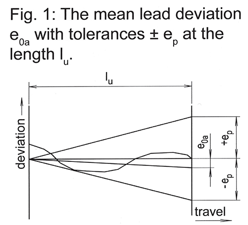

Figure 1: To specify lead accuracy, three values are commonly used: ep, e300, and e2π to find the average actual lead deviation over full travel, deviation per a 300 mm interval, and the lead variation within one revolution of a screw thread.

ep – is the average actual lead deviation over the full travel of the nut on the screw.

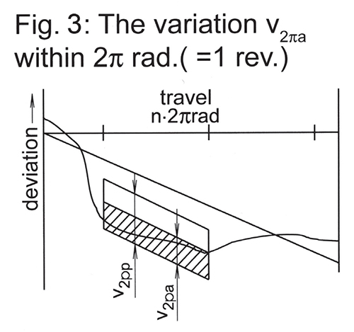

e2π – is the lead variation within one revolution of the screw thread. This parameter has more impact on equal load distribution among the balls than on axial nut travel, and thus may affect the predicted life.

Figure 3: The lead variation within one revolution of the screw thread parameter has indicates load distribution among the balls (more so than on axial nut travel), and may affect the predicted life.
