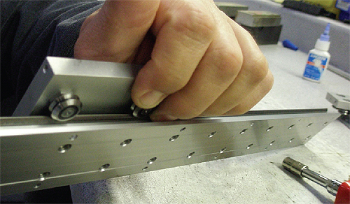

Pre-loading requires only a few simple tools and the proper positioning of the wrenches for adjusting eccentric wheel preload.

Begin by placing the carriage on the track assembly with the concentric wheels fully tightened and the eccentric wheels finger-tightened within their mounting holes. Using one hand, insert the open-end wrench between the eccentric wheel and the mounting plate to engage the hex flats of the bushing or stud on the wheel. Use the other hand to hold the open-end wrench or socket wrench on the wheel’s fastener.
Use the wrench to slowly turn the hex clockwise until you feel resistance; this indicates that the wheel is contacting the track. Then, with the wrench still held in position with one hand, tighten the eccentric wheel’s fastener to lock the wheel in the adjusted position. The reason for turning the hex counterclockwise is so that the any radial load between the wheel and track will cause it to turn clockwise, creating a tightening torque on the wheel’s fastener.

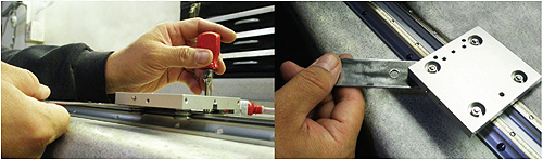

To check the level of preload, hold the carriage in place with one hand and rotate the wheel with the index finger and thumb of the other hand; the wheel’s running surfaces should be able to slide on the track when the wheel is rotated with moderate hand turning effort. If the wheel can’t be rotated, adjust the wrench position to reduce the preload and try again.

Check the level of the preload by manually rotating the wheel.
