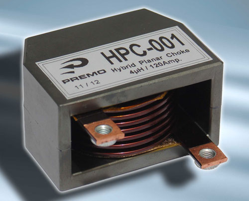

PREMO presents a version of its HPC series, a high power choke with planar technology for DC/DC converters applications for electric traction and high-density power electronics, especially recommended in hybrid and electric vehicles.
The HPC series offers excellent performance (better than 95%) at 100 to 150 kHz frequencies respectively, being able to extend the operating range up to 250kHz.
HPC
Materials used in the development are H thermal class, which allow reaching operating temperatures up to 180°C. Flat wire coil technology used allows getting components that can drive high power density and high currents (up to 200A) in a low-profile component (max. height 27, 5 mm), therefore minimizing losses very low series resistance.
Its high stability in temperature and wide operation range, from – 40 to 125°C, make it specially suitable for industrial environments and automotive, since it enables an easy assembly on cooling surfaces through radiators.
The HPC series is available in a range of inductances of 2 to 5uH. It is possible to customize its outputs. The standard option is threaded inserts metric 4.
This product is fully certified under the strict quality standard for automotive electronic components: AEC-Q200.
