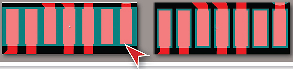

solder-mask-problem
Solder masks created by PCB CAD programs are rarely problem free. In this case, (left) the solder mask openings are so expanded that the clearances overlap, obliterating any mask dams between surface mounts. A lack of mask dams can cause significant bridging during the assembly process if left as-is. One way to fix this problem is to either adjust settings in the PCB CAD program to create a global expansion equalling half the distance of the design’s smallest circuitry space, or create a global “no swell” (pad-master). Then the board house can adjust according to its capabilities to provide coverage on the board where needed and appropriate openings for solderability.
It isn’t just Gerber files that can output incorrect information. PCB CAD packages are notorious for not producing solder masks the right way. Solder masks can be a touchy situation because engineers often don’t think too much about them. You have to make sure the mask leaves the pads open so they’ll take solder while leaving protection between the thin lines of solder. That’s tricky where there are tight clusters of surface-mounted components. The trouble is that PCB CAD packages don’t provide a lot of help with getting the solder mask right. It is another area where the board fabber can help.
