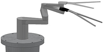

In addition to other design constraints, the wafer-cooling station must accommodate the multi-degree-of-freedom maneuvers of the robot as it manipulates the wafers.

Creep analysis of polymer components verified proper function over time and temperature.  Static and dynamic stress analyses confirmed that the mounting interface could handle forces encountered during assembly and operation.  Modal analysis evaluated wafer-positioning accuracy given oscillation of the robot during operation.

These magnified mode shapes of the robot arm in different configurations illustrate the potential effect of oscillation induced during operation.  Additional clearance is required to accommodate the oscillation amplitude when picking and placing wafers.
