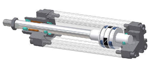

A closer look at designing a new range of pneumatic sealing systems
Trelleborg Sealing Solutions has been working with customers to develop a new line of pneumatic sealing systems. Demands in the market indicated the need for a more robust, longer life, and more cost effective sealing system for pneumatic cylinders. After gathering market data, the best value for cylinder performance turned out to be a sealing system that would work well in the following environment:
• in oil-free compressed air with minimal lubrication at startup
• compressed air conditions of 100 psi, with 230 psi maximum pressure
• a working speed range of 100 fpm, with maximum short term excursions to 400 fpm
• low friction and no stick slip during operation
• lifetime travel of 4000 miles
To achieve this balance, the design team addressed
materials, designs, and process improvements concurrently. The result was a focus on three areas:
• Develop suitable Zurcon® polyurethane materials that would offer excellent wear and abrasion resistance with the right strength, chemical compatibility, and friction characteristics required to achieve long life, excellent sealing, low friction, and appropriate total system cost.
• Develop appropriate geometries with rounded contact area at the seal lip to maintain grease film, small lip thickness for low radial force and friction, air channels to allow proper pressure activation, and other features available through the use of the low hardness Zurcon material. FEA and product testing validated and confirmed the performance of these features.
• Develop and validate the use of an injection molding process that limits cost and provides the required material properties.
Tests were done to ensure that proper balance was achieved between leakage, friction, system cost, and lifetime measurables. The graph on the right shows an
endurance test conducted to determine the rod seal leakage during the course to see trends related to leakage at 29 psi and 145 psi. Other validation tests included breakout friction, low temperature performance, high-pressure tests, and bursting pressure tests.
To study the effects of leakage, friction, and wear on the geometry and material, this FEA analysis shows a sealing profile at 29 psi and 145 psi.
An endurance test for rod seal leakage showed leakage trends at 29 psi and 145 psi.
