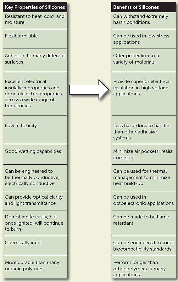

Silicones adhere well to many surfaces and offer a number of other beneficial properties, (Table 1). They have a relatively low dielectric constant, high dielectric strength, low dissipation factors, and are exceptional electrical insulators — properties that are little changed over a range of frequencies. Silicones are durable, standing up to wind, rain, and ultraviolet light exposure with minimal effect on physical, mechanical, and electrical properties.
Silicones can typically withstand temperatures ranging from roughly -55°C to 200°C — with specialty formulations resisting temperatures as high as 300°C — while maintaining their other useful properties. The actual service temperature range and degree of temperature stability of a silicone can vary, depending on the specific chemistry of a formulation. Because of their stability over a range of temperature, humidity, and frequency, silicones are often selected for use in applications subject to challenging operating conditions.

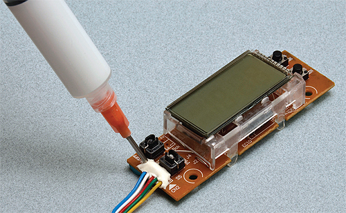

Sealing and bonding

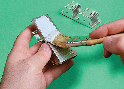

Silicones are commonly used to seal and bond substrates in the assembly of printed circuit boards (PCBs) and modules, and are the only type of adhesive that will adhere to a silicone substrate. Electrically conductive silicone adhesives can be used in place of solder for component attach. Thermally conductive grades can be used to bond microprocessors, LED (light emitting diode) arrays, and other heat generating components to heat sinks, ensuring an efficient path for heat transfer. Because silicones’ properties remain stable when subjected to high temperatures, they can withstand the heat that is characteristic of many operating environments.
