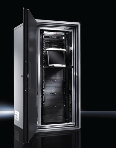

A micro data center is a complete data center within a protective safe and provides all the essential features of an IT infrastructure:
  • power distribution and cooling
  • early fire detection and fire extinguishing system
  • monitoring of operating parameters and alarms
The shell design provides appropriate protection from potential physical threats such as intrusion, vandalism, fire, smoke, water and dust.
The key features are:
  • two designs for the protective shell with different levels of protection against potential physical threats
  • energy-efficient cooling from 5 to 30 kW
  • range of climate control options
  • a “bayable” design makes it easy to scale up as needed
Particularly for small companies, but also for workshops and remote locations, a micro data center offers complete all-round protection for important IT devices such as servers, switches and storage systems.
