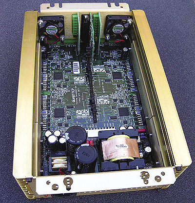

Testra’s SoftStep driver modules come in a variety of sizes, such as the ss483 Series, as well as the ss4x483 quad-step system, a four-axis drive system including power, I/O interface to the machine being controlled, and an interface to a PC for control. The ss4544 system is a stand-alone unit with an embedded motion control computer and CNC machine control firmware.
“The Stinger is a three-axis machine, but we can upgrade to include a lathe on our machine. Since the SoftStep drive system comes with four drives, we already have an extra drive available. So, the customer can install their fourth axis machine without doing any additional wiring. Also, if a customer is not using the fourth axis, if one of the three drives goes out in the future, they have an extra drive available to get them back up and running in a matter of about one minute,” Jarrard says.
