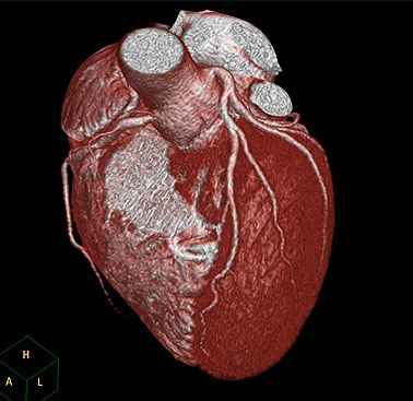

The procedure to image the heart and see the details of the vascular system that feeds the heart wall with oxygenated blood is technically demanding. This procedure, known as Cardiovascular Computed Tomography Angiography or CCTA, is an emerging application. It can evaluate the presence of occlusive disease and the efficacy of subsequent interventions in coronary vasculature. There are challenges inherent in the imaging of the coronary arteries associated with the motion of the heart. The challenge in achieving high image quality and visibility of sub-centimeter coronary vessels is to time the exposure to the most quiet moment within the cardiac (heart beat) cycle. The success of the CCTA examination of the coronary arteries is dependent upon the optimization of a number of enabling technologies, most importantly the ability to achieve higher rotation speeds.
Image of the coronary arteries in a patient with a heart rate of 80 ± 6 bpm. Images were acquired in end-systolic coronary rest phase using a 0.27 second rotation time. Images courtesy of Washington Hospital Center.

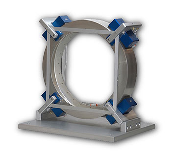

The non-contact air bearings use a microscopic film of air instead of a ball bearing as the ‘virtual’ point-of-contact between the rotation ring and the static, non-rotating frame. The surface of these Porous MediaTM bearings consists of millions of sub-micron sized holes through which air is evenly distributed. Conceptually, this porous carbon pad is the substantially more sophisticated equivalent of an air hockey table. The non-contact surface virtually eliminates friction and is capable of achieving very high rotation speeds; enabling Phillips engineers to reduce CT scan time while improving temporal resolution.
In late November 2007, Philips introduced a prototype of the AirGlide air-bearing technology at the Radiological Society of North America (RSNA) Show in Chicago, Ill. In development for more than six years, AirGlide technology floats the Brilliance iCT gantry ring on just a few microns of air, allowing a frictionless and stable rotation, while maintaining focal-spot-to-detector element integrity at very high speeds. The radial air bearings enabled Philips to achieve a rotation time of 0.27 seconds; almost four revolutions per second versus three for the conventional contact bearings.

Improving reliability in the field was another clinical requirement for Popilock. The Philips engineers believed that a non-contact surface that could reduce friction would be ideally suited not only to deliver the higher rotation speeds necessary to achieve the shortest acquisition time, but also the stability required to reduce the effects of vibration associated with the operation of ball bearings at high speeds.
The Brilliance iCT should operate for 15 years without changing a bearing ‘pad.’ Plus, the air bearings function without contact, so there is no wear. In fact, maintenance is reduced because there are no requirements for lubrication.
Prototype of air-bearing gantry design.
