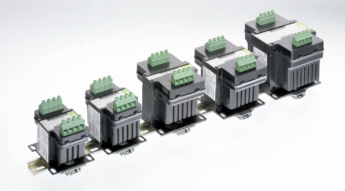

MIDDLETOWN, Pa. — Phoenix Contact introduces the new CPT series of control panel transformers. The CPT series is designed specifically for high inrush applications that require reliable output voltage stability.
The CPT is a cost-effective and easy-to-install power distribution and supply solution. The transformers maximize inrush capability and output voltage regulation when electromagnetic devices are initially energized.
The CPTs feature a unique DIN rail-mount foot, or they can be panel-mounted. They have touch-safe COMBICON connectors with dual secondary connection points.
All CPT devices accept single-phase input voltages of 220, 230, 240, 440, 460 and 480 V AC. They provide output voltages of 120, 115, or 110 V AC with VA ratings of 50, 100, 150, 250 or 500 VA.
