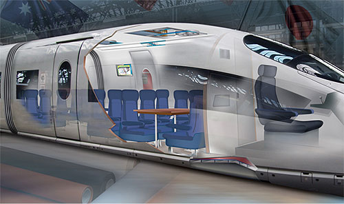

New standards requirements for railcars require newer materials, such as silicone foams.
