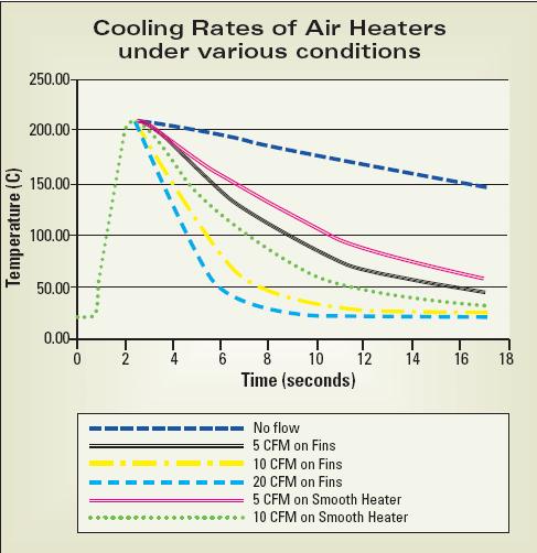

As expected, initial testing showed a strong relationship between the heater air flow rate and cooling rate. The presence of fins also increased the cooling rate.
This graph shows the time-temperature curves for the standard heater with 5 and 10 CFM air flow rates and for the finned heater with 5, 10 and 20 CFM air flow rates.
The calculated cooling rate and heat transfer coefficient data shown in Table 1 uses an approximation of the heater as a single lumped mass, implying an assumption of uniform temperature within the heater. This assumption is logical since the AlN matrix is very conductive with a thermal conductivity of approximately 140 W/m °C.
However, the temperature/time curves indicate that it takes more than 0.5 s after power is removed from each heater to reach the peak measured cooling rate. This behavior is true even for cases where the airflow is on during the heating process, indicating that the heater sensor measures a temperature lower than the peak heater temperature at the start of cooling due to its position within the heater matrix.
Additionally, it is likely that the local heat transfer coefficient is greater near the center of the heater where the incoming air impinges on the underside of the heater, and lower near the ends. The transfer of heat from the heater to the air is also retarded near the ends by an increase in the air temperature as it flows along the heater. The variation in local heat flux drives a temperature gradient in the heater during cooling that in turn causes an underestimate of the heat loss during the initial 0.5 to 1.0 s of cooling and an overestimate later in the cooling process. The data for average heat transfer coefficient presented in Table I is averaged over the time of the cooling process as well as over the area of the heater to compensate for the error in cooling rate measurements.
The cooling rate of the heater without flow indicates that approximately 4 to 5 W of heat were lost to the mechanical support structure and to the working surface of the heater when it was near 200°C, that is Qo is between 4 and 5 W. This heat loss is not significant relative to the heat flow of the forced air inside the duct and therefore moderate variations in heat loss other than to the airflow in the duct are negligible.
The average coefficients of heat transfer calculated for the finned heaters are lower than those for the standard heaters despite the fact that the reduction in cross-sectional area for flow actually increases the flow velocity in the duct. The difference is likely due to the temperature variation along the length of the fins; the fins are undoubtedly cooler at their tips. However, even with the reduced heat flux per unit surface area, the amount of heat transferred from the heater to the air is significantly higher for the finned configurations as the simplified equation, Qc = h A ?T, would indicate. The three-fold increase in surface area has a greater effect on the heat transferred than a 40% lower heat flux.
