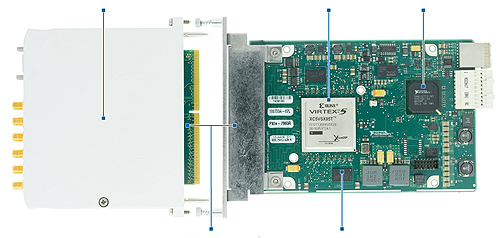

NI FlexRIO modules feature customizable I/O adapter modules, a user-programmable onboard FPGA, and a PCIe interface that enables peer-to-peer communication between boards or data transfer to a controller via DMA.

One approach to solving these challenges is taking advantage of an off-the-shelf FPGA-based system such as the NI FlexRIO, which combines a CompactPCI-based (PXI) I/O module with onboard FPGA and a customizable front end for high-bandwidth A/D conversion, high-speed DIO, custom triggering, and other operations. Since FlexRIO is modular, it can be combined with other instruments in a chassis or upgraded, with a larger FPGA for example, as needed.
