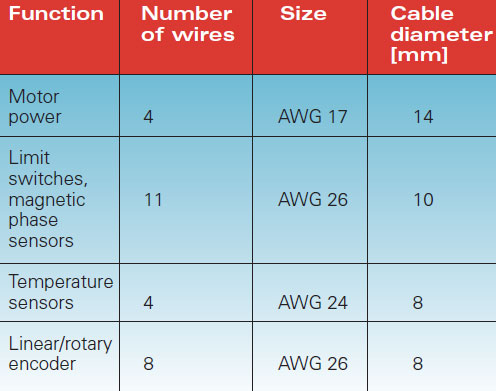

Cable reduction can be especially useful in wafer inspection systems, which typically consist of a stack of XYZ linear stages plus a theta rotary unit. There can easily be 16 connectors at the final electrical terminal with over 100 wires, many of which are in constant motion during system operation. The disadvantages and potential problems of this many cables include:
1. All moving cables must be accelerated, moved, and bent by the stage system itself, which raises driving force, causing an undesirable temperature rise.
2. The bend resistance of the cables is not constant. The result is stick-slip plus randomly distributed effects that complicate precision positioning.
3. Moving cables generate particles and tend to outgas, which is undesirable in clean room applications.
4. Stage system reliability is reduced in proportion to the number of moving electrical lines. The higher the number of moving cables the higher the risk of a failure or defect.
5. Electromagnetic interference between cables may cause crosstalk, creating problems in system integration.

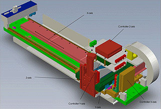

How? Replace central multi-axis motion controllers with single separate control modules mounted directly to the axes.
These modules, connected by a high-speed bus interface, even allow interpolated movements between different stages.

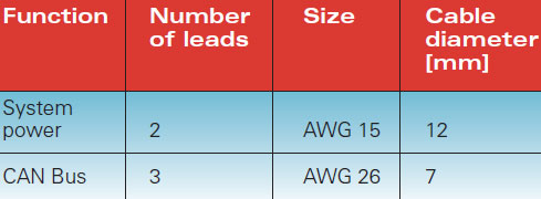

By miniaturizing the electronic PCBs, the size and mass of the individual control boxes is smaller than a comparable cabling system. For a 3-axis XYZ system, instead of a huge number of moving wires, there are three moving control modules, a tiny three wire shielded CAN-bus cable in a daisy chain configuration and two wires for power.
In total, the complete system needs just two separate cables with diameters of 7 mm and 12 mm independent of how many axes the stage system includes. The five electrical leads are easy to handle in one moving cable carrier.
Each axis carries its own motion controller independently. All leads to motor, sensors, and encoder systems have a length of typically less than 20 cm. More important, all the electrical connections to the upper axes are static, which means there is no bending or relative movement of the cables.
With a single linear motor driven stage, each axis can require up to 4 separate cables with diameters of 8 to 14 mm.  That means up to 27 electrical wires must be connected. But, replacing a central multi-axis motion controller with single separate control modules mounted directly to the axes can significantly reduce the number of cables in the system.
