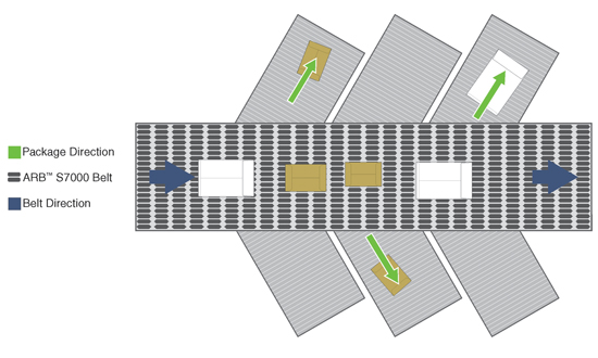

One of the latest advances in automated conveyance involves reinventing the way packages moved from point A to point B. The Intralox patented Activated Roller Belt (ARB) equipment brings the benefits of modular plastic belting to conveyance applications to enable greater flexibility, higher throughputs, reduced footprint, and simpler control.
ARB technology makes it easy to work with conveyor systems that have multiple requirements. This drawing illustrates packages being sorted on the ARB S7000 belt.

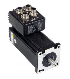

To maintain control and increase the flexibility of the ARB equipment, Intralox uses multiple STM/SWM integrated stepper motor packages (motor, drive, and control in one package), designed and manufactured by Applied Motion Products.
STM/SWM integrated stepper motor packages from Applied Motion Products have been designed for user flexibility.
Major advantages and features are gained from having a single package solution. For example, the stall detection and stall prevention features of the STM/SWM package allows the ARB to operate each stepper motor in a similar way to operating a servo motor—eliminating the concern over stepper motor “slip.” Further, the Q-Programming feature of the STM/SWM allows the user to create custom operations. This allowed Intralox to develop a “variable following” technique that provided efficient, flexible positioning, plus allowed them to easily modify the motor operation as required.
The configurable operational modes of the STM/SWM integrated stepper motor further supported the Intralox designers’ need to match the proper operational mode to the requirements of each specific product type or application.
