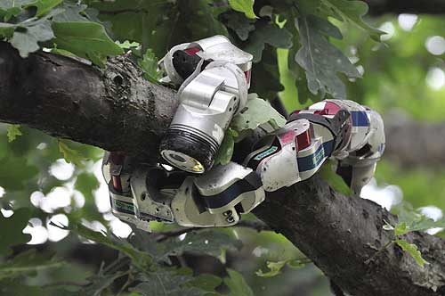

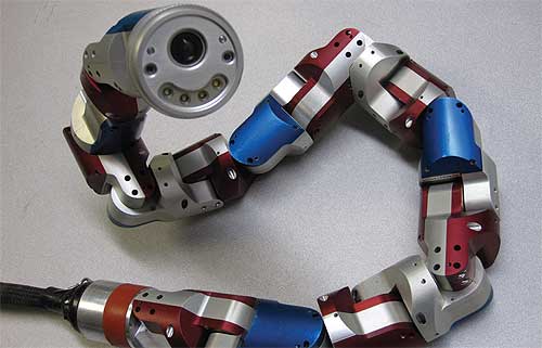

Snake robots
Biological inspiration: Snakes
Developed by: Carnegie Mellon University’s Robotics Institute
These robots are highly articulated mechanisms that can thread through tightly packed volumes, reaching locations that people and machinery otherwise cannot. Their ability to move through a myriad of terrains suggests a broad range of applications: They are likely the only mechanism that can traverse a field, swim through a small pond, breech a fence and then climb a flag pole.
They can move into and through areas in a minimally invasive manner, which is important for military rescue operations, since they do not disturb potentially fragile situations, and for surveillance missions, since they can covertly access hard to reach locations. They can also be used for battlefield medicine in applying therapies in the field. Finally, these robots can be used for infrastructure inspection.
The university’s family of modular snake robots have demonstrated a variety of locomotion capabilities, including climbing up a 50-ft crack in a building, climbing up stairs, swimming in a pond, climbing along a pole, falling one story, crawling through floor spaces and maneuvering through brush.

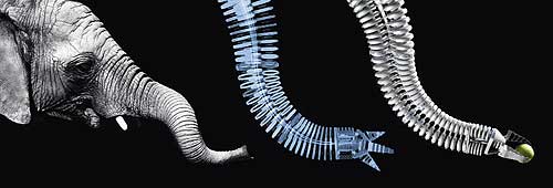

Festo’s BHA project had the initial aim of developing a system for a safe human-machine interaction. Such a system should have a high flexibility and sufficient accuracy.
Bionic Handling Assistant
Biological inspiration: Elephant trunks
Developed by: Festo Corp
The Bionic Handling Assistant project was based on the development of pneumatic lightweight structures by Professor Dieter Mankau at the Offenbach Academy of Art and Design, and the additive manufactured bellow from the Fraunhofer Institute for Manufacturing Engineering and Automation in Stuttgart.
By analyzing the structure and functioning of the elephant’s trunk, and with the use of new manufacturing technologies, Festo engineers developed an entirely new biomechatronic handling system. The elephant’s trunk is a fascinating model instrument—it is flexible, transmits large forces and serves as a precise gripping tool, thanks to a hierarchically arranged system of muscles and evolutionarily optimized movement patterns.
At first glance, the BHA resembles an organic structure, reminiscent of an elephant’s trunk or a vertebral column. It consists of three basic elements for spatial movement, along with a hand axis and a gripper with adaptive fingers. Each actuator is supplied with compressed air at the interfaces of the basic elements. Resetting is effected by the loop-like design of the actuators, which act like a spring when the compressed air is discharged. Bowden cable potentiometers on the outside of the actuators register their extension and control the system’s spatial movement.
Kaminski said that an elephant’s trunk is one of the best examples in nature that shows these properties.
“One big challenge in the design process was the reduction of weight,” he said. “This was [solved] by using a polyamide processed by selective laser sintering. This material has, in general, a density less than 1g/cm3 and it was truly the key for a real lightweight construction. But also the structure of the system itself was strictly reduced to its functions as it can be observed in nature.”
Festo engineers had issues with adjustment of the wall thickness of the construction in relation to the air pressure that was needed to generate the movement. Kaminski explained that there is a complex relationship between the design of the shape of the cross-section and its effect on the movement behavior of the system.
“The integration of sensor technology was a further challenge during the development process,” Kaminski said. “In this case, we used Bowden cable potentiometers. These potentiometers were long and flexible enough to create a good signal all over the system.”
