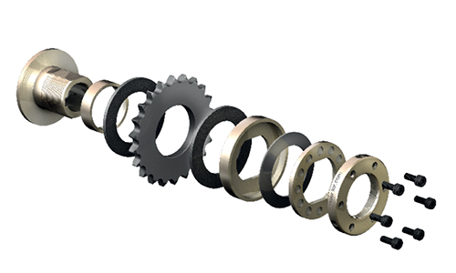

Here we see an exploded view of KTR’s Ruflex torque limiter.
“One of the things that I try to understand first, is whether or not the torque limiter will be used only for catastrophic failure, or if the customer is looking to slip frequently: are they expecting more slips than usual? That, then, tells me whether I want to use an economical friction style torque limiter, or if I want to use the ball detent designs, where they can slip, catch a limit switch, shut off, and then reset themselves, and begin operating again. They typically can be slipped multiple times through their application, where a friction torque limiter has to be reset every time.
I also try to determine whether a zero backlash component is needed, and address other typical industry questions. The biggest misconception that I want to make sure people understand is that a torque limiter is not a clutch, and therefore they’re not intended to be continuously slipped.
They generate a lot of heat, obviously, with those frictional connections, and so once a torque limiter slips we want the system to be shut down as soon as possible. We obviously then want to inspect that torque limiter, and check for any wear, or heat damage. Re-checking the setting torque is also important; it will decrease quite a bit if it’s been run too long. We want to make sure that we’re still in the range that we need to be in so we’re not slipping more and more. The way we do that is either with a limit switch, or a proximity switch, and some type of control device. That way when the torque limiter slips, it sends a signal, and shuts the system down so the customer can do whatever it is the torque limiter was designed to catch, or do.”
