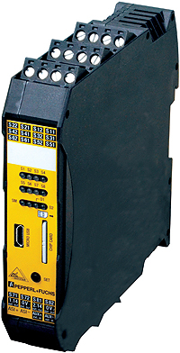

Safety-at-Work-safety-controller
The Safety at Work safety controller is a compact device for stand-alone applications. It also offers the ability to transmit diagnostics data to its AS-Interface expansion port. A modern USB configuration port and a SIM memory card are considered state of the art and simplify usability and maintainability.

Safety at Work “stand-alone”
Recently, a new version has been released to the market addressing the need to offer a flexible and compatible system for even the smallest safety applications. It is a Safety at Work controller that offers the following:
•Stand-alone operation using four on-board safe inputs, and two on-board safe outputs.
•Integrated expansion port allowing the system to grow as needed.
Configuration using SIMON+
SIMON+ has a 10+ year history of development and use. Current users of Safety at Work can use the same software tool for all their safety applications. Beginning users, perhaps working on their first small safety system using the stand-alone Safety at Work controller, won’t have to start from scratch if they are faced with growing safety needs.
When used as a stand-alone device, this safety controller is comparable to other “configurable safety relays” on the market. With four safe input channels and two safe outputs, many small applications are easily addressed. This I/O mix was selected because the cost of the product is low enough to be competitive in situations where two or three conventional safety relays may otherwise be used.
Safety logic for the Safety at Work controllers is easily and quickly put together using the graphical SIMON+ tool. Configuration blocks are dragged from the Device Library and dropped on the Configuration Window. Each configuration has a number of parameters that are accessible through its Details Window. Simon+ is used for stand-alone safety controllers and those that come with an integrated gateway to other PLC networks.
One of the main features of this safety controller is the integrated expansion port. This port uses AS-Interface as the communication method between the safety controller and the expansion devices. The Safety at Work approach allows modules to be as close to the controller or as far away from the controller as necessary. Using the expansion port, you can:
•Add up to 32 PLe-rated safety devices.
•Add up to 8 independent PLe-rated safe output channels.
•Connect up to 124 nonsafe inputs and 124 nonsafe outputs.
Now that the Safety at Work technology can be used for installations with as few as two or three safe inputs up to installations with nearly 1000 safe inputs, all configured with the graphical SIMON+ configuration tool, you can inexpensively address your safety needs. Plus, your system can initially be small and grow significantly without throwing away components. The integrated expansion port gives the stand-alone safety controller the ability to handle safety systems of significant size.
