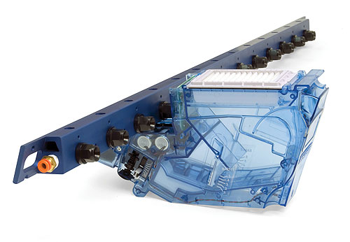

Seal-coupler from MR&P reliably connects components in the pneumatic motion system of Parata’s Max and Mini automated pill dispensing system for pharmacies. The seal-coupler (new design left) replaces an earlier design (right). The seal coupler connects to pill dispensing cells (below) also manufactured by MR&P.

In the pneumatically actuated system, the seal-coupler is a critical intermediary device. Positive sealing is imperative so no pressure changes occur that could affect compressor function, airflow rate, and ultimately pill count speed and accuracy.
When activated, regulated pneumatic pressure moves the pills from individual cells that both store and dispense. These are “smart cells” with an electronic circuit board that broadcasts the cell’s location on the system, so the robot always selects the correct cell for dispensing.
The seal-coupler is a spring-loaded device with a molded lip-seal that locks connections together in the pneumatically driven motion system.
The new seal-coupler is a spring-loaded assembly with an upper and lower housing molded from a nylon material that is ultrasonically welded together. Within this housing, a spring is centered on a retainer at one end and a poppet core on the other end. This poppet core, under tension from the spring, locks into a special lip seal molded from a durable, proprietary elastomer material.
The lip seal design addressed the initial problem of seal alignment with a more precise-fitting lip configuration at the seal end. The elastomer material improved wear resistance with a leak-proof connection to the high-pressure system.
