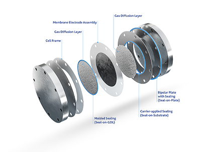

This kind of production concept, however, requires components that are designed for mostly automated assemblies from the start. This applies especially to seals, which provide reliable media separation during the electrolysis. The component size itself is one of the challenges: in some cases, seals with a diameter of up to one meter are used. Not only does this make the seals more difficult to handle, it also places high demands on the installation quality to ensure that the surface pressure is uniform and the tightness is guaranteed for the entire service life.
One of the solutions pursued by Freudenberg is based on molding the sealing material directly onto the functional part. The company is already using a similar process to produce gas diffusion layers in fuel cells. Alternatively, the seal can be applied to or inserted into specialized carriers, which in turn are easy to transport and install.
