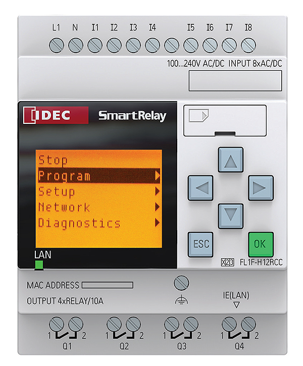

Relay-based controllers were very basic when first introduced and only suitable for use in place of a few relays and timers. But now, the capabilities of these smart relays are approaching those of micro PLCs, making them a good choice for control of simple machines. These expanded capabilities have led to increased demand with more than a million units purchased per year and an annual projected growth rate of 6%.
Most smart relays come with an integral front panel alphanumeric display (Figure 1), and some also feature an optional external text display panel. Typically, both displays show the same information, with the external display used when the base unit is mounted inside a control enclosure and thus not visible during normal operation.
Although most smart relays can be programmed through their display, it’s more common to use PC-based programming software, which is usually supplied free of charge with the relay. Once programmed, at least some of the smart relay’s settings, such as alarm settings and other values, can typically be modified with its display.
Newer smart relays have an Ethernet port in addition to a serial or proprietary communication protocol port. This Ethernet port can be used for connection to the PC for initial programming, and then for connection to other devices once programming is complete. These other devices might include the external text display panel, other smart relays or an Ethernet switch.
Some newer smart relays have built-in web server capability, allowing web pages to be programmed and stored in the unit for remote access with any web browser. This feature connects the smart relay to the world through the internet, useful for remote access. Some suppliers are also writing smartphone apps to enable communications with their smart relays with Apple and Android phones, which greatly increases speed and ease of remote access.
Ladder logic or function block are the programming languages of choice, which makes it easy to write efficient programs for simple operations. Internal program storage is limited, so operations can’t be overly complex. Smart relay I/O used to be strictly discrete, but analog I/O is now becoming available on some newer units.
With respect to maximum allowable I/O, IDEC’s FL1F SmartRelay can handle up to 60 I/O with its base unit and expansion model. These 60 I/O consist of a maximum of 24 discrete inputs, 20 discrete outputs, 8 analog inputs and 8 analog outputs.
