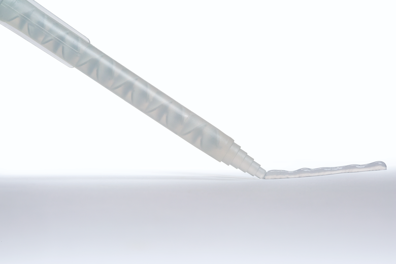

Lastly, on the process side, Hess advises engineers to think about scale and construction.
“If you’re making just a tiny little unit, that’s going to have different processing considerations, as opposed to building the whole aircraft. So, you might need to look for materials with specific packaging, like either side-by-side kits with easy dispensing, all the way up to drums, which might need specific types of equipment to meter it out, mix it, and then dispense it,” he said.
“There are also different types of rheologies that silicones will have, or flow characteristics that are better suited for certain areas. If you have vertical joints or curved surfaces, you might need a thixotropic material that won’t slump or fall over and hold a nice bead shape once it’s been dispensed so that you can join two parts without it falling on your head. Other complex geometries or large surface areas might need really flowable and self-leveling adhesives that will find the level and flow out into all the nooks and crannies of a geometry.
“There’s also a certain class of adhesives called film adhesives that are either in a sheet or a roll, and after preparing a surface, you can apply the film and it will cure into a permanent elastomeric film, which is kind of like a permanent tape, if you will. This is really useful for large array manufacturing. That’s going to give you a nice, consistent bond line across a big array. And these arrays can be quite large, several 100 square feet at a minimum. So, this also avoids any mixing and dispensing operations, so you can instead stick a film over it and allow it to cure at room temperature, instead of having any mixing or cleanup for liquid adhesives.”
